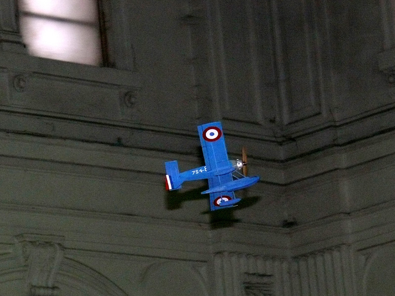

Avia BH-3, PZL 8: Martin can cut almost transparent plates from pink or blue foam using resistance cutter (about 0.2 mm thick, we saw the sample - great !). Plate can be painted with spray embedded material and sanded - weight increase in minimal. Unfortunatelly the technology was invented during the built and Avia peanut is made of 1 mm plates, sanded and sprayed with Humbrol, the weight is over 10g and trimming is difficult, rubber 3.2 adds more weight, there was not enough time for trimming...
Similarly there was not enough time for trim flights of Martin's second model, this time of classical design. Almost every model can be trimmed, but speed increases with weight as well as precision required.
