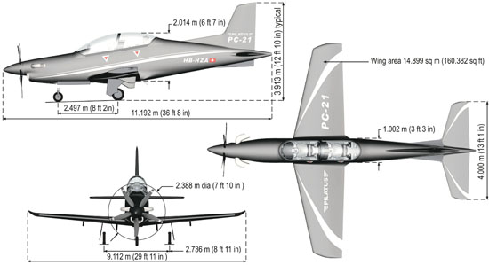

Ahoj kolegové,
chtěl bych do Trnávky spáchat dvacetinu Pc-21....bohužel jsem našel na vebu jenom jakejsi pochybnej trojpohled, neví někdo o nějakým rozumným obrázku s řezama trupu? Dík

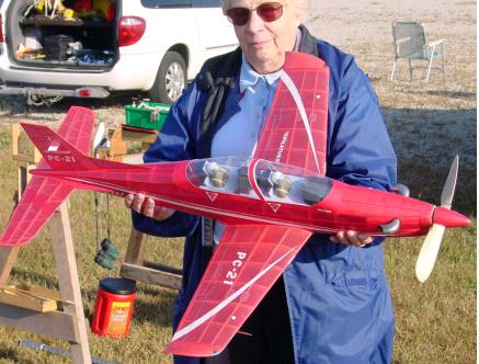

this pc-21 is not the usual development of the chzec masters plans and build but is only an example of the model of Jim Bair's Pilatus PC 21 and an image of the coopkipt
interiors of pc21.JPG (26.09 KiB) Zobrazeno 12918 x
pilatus pc21 model.JPG (36.16 KiB) Zobrazeno 12918 x

Thank You Marcelo!
All those pictures I´ saw before....when Im build me FSK Pc-21. Looking for some kind of blueprints...BTW this final picture of FF scale PC-21 is not 1/20 scale, it look bigger to me, It look the same size as FSK Pc-21. Maybe I´can build it the same size as FSK Pc-21...but do not know If it will be possible to fly with it on Trnávka FF scale competition because she will be not 1/20 (and I have to be honest, I just did not understand the rules of this class) :oops: ....Mean Ist easyiest way for me to make FF scale Pc-21 according FSK PC-21 size, have two of them home, so I´can build it and fly it just for fun, not for competition....will see.

dear ff radek: Jérôme Zbinden,Assistant Chairman’s Office of Pilatus Products, sned to me this files at my request. i not have permission to post in public forum but i have permission to shared the link direct to pilatus products, here you find a files very completly in 1/20 scale of all products of Pilatus hope you enjoy!
http://www.pilatus-aircraft.com/00-def/ ... 20Plan.pdf
http://www.pilatus-aircraft.com/index.php
if you prefere i can send via mail the pdf file, just tell me and send to me your mail adress iam very ery glad to send to you.
iam very interesting in this model and ver impatient to see the completly development from 3 iews to plan to model finishing here! is a privilege to me and my students watch and learn from the chzec masters!!!

Příspěvek od FF Radek » 26 črc 2011 21:14
Dear Marcelo!
this 3wiev of PC-21 is more than I´was hoping for, as soon as will finish me "sheet metal work" on me Pc-6 will start Pc-21....love all Pilatus products :)

Příspěvek od Lubomir Koutny » 03 pro 2011 21:54
Nerad odrazuji nadšence, ale nemohu si odpustit pár poznámek. Tento typ má velký trup a poměrně malá křídla. Má-li dobře létat, pak celá stavba musí být mimořádně lehká, hlavně na velkou kabinu to chce velmi tenký celuloid, kabinu vybavit, nemůžeš tam nechat obrovskou prázdnou díru !. Do stavby se může pustit každý, dobře to však bude létat jen tomu, kdo perfektně zvládne vícelistou vrtuli, ta musí mít vysokou účinost, což u malého průměru (daného 35% z rozpětí) není snadné.

Příspěvek od FF Radek » 10 čer 2012 09:35
Musím přiznat pane Koutný, že jsem zvážil veškerá pro a proti, Pc-21 mě pořád hodně láká, jeden z důvodů je ten, že mě PC-21 velmi příjemně překvapil svými letovými vlastnostmi jako mala RC maketa...uvidíme, výkresy mám nachystaný, materiál nařezanej....trošku mě děsí právě ta díra kokpitu, je to hodně velký zeslabení konstrukce a jakejkoliv nápad na zpevnění trupu je buď těžkej, nebo nemaketovej...uvidíme, stejně kvůli "plechovkáčům" na to zatím nemám čas ale při chvilkách to snad pomaličku půjde...
